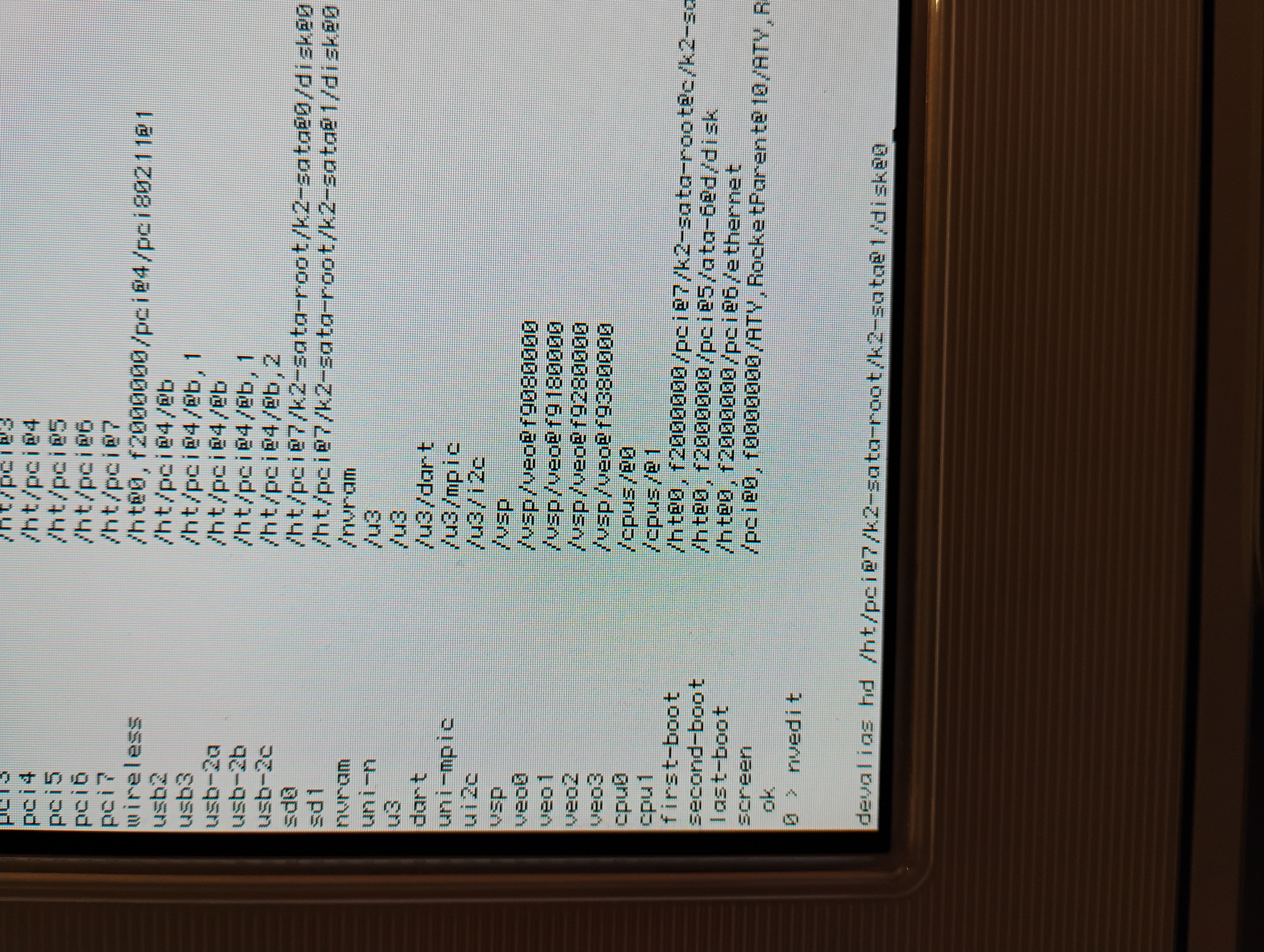

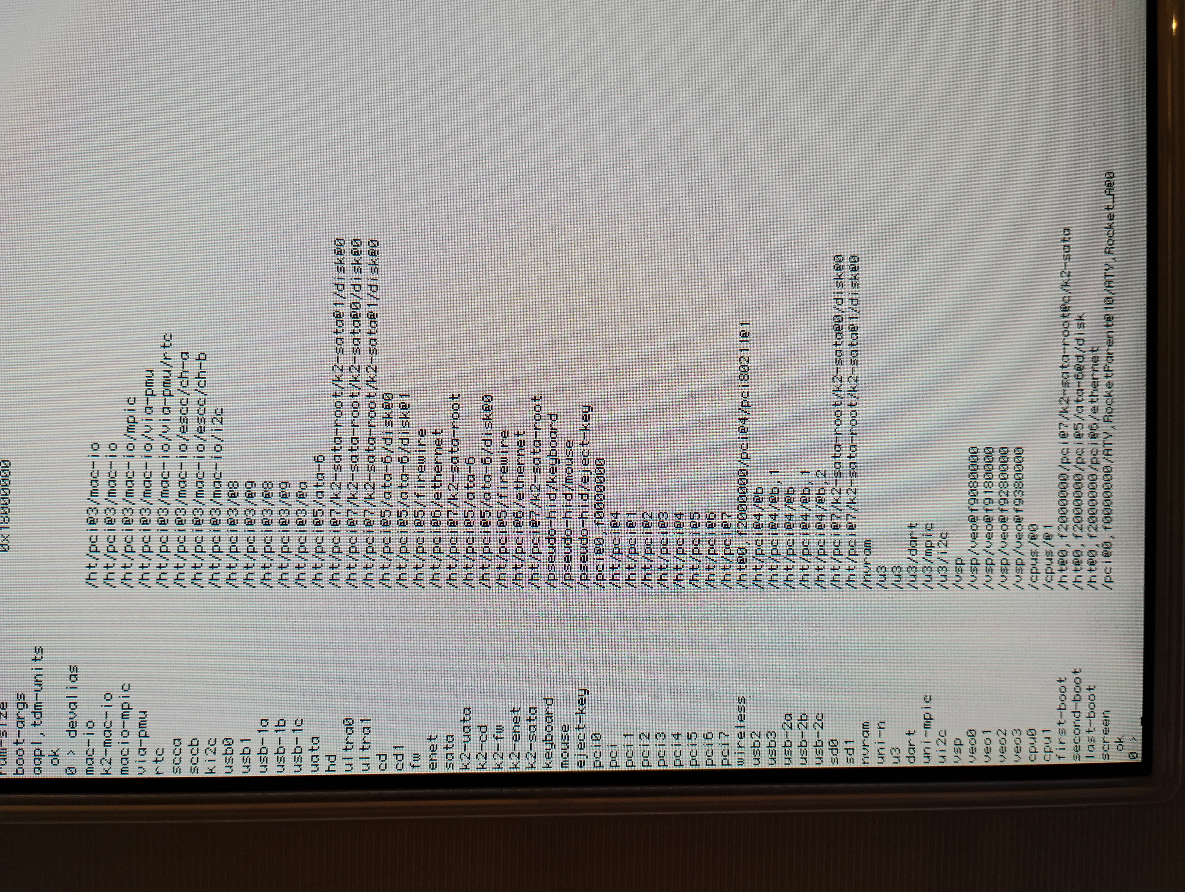

    I also took photos of the different info. in OF: printenv, devalias, and nvedit. In nvedit, there's only the devalias needed for "hd" to point to the boot partition of MorphOS. With this alias, I can do "dir hd:\" and see its contents, without I'd get an error (recall this post).
    Cheers!

    PS. Forgot to mention that I tried yet another SATA disk, a 2.5", with the same behaviour: I can install MorphOS no problem, but I must go through OF to boot...

    Lower bay for hd is OK!. There should be no need for pointing to this port in nvram! This path is created by OF on the run!
    Unfortunately I cannot see your pics ( printenv, devalias, and nvedit) - your pic-host (chingu) is classified here (now?) and has been blocked.
    Please use another hoster (someting like that: https://picr.de/upload.html).

    Yes, regarding the alias "hd", I thought so too but without it, "dir hd:,\" would fail...
    I don't know why my site should be blocked  ;-)
    I uploaded the three photos here (a Google Folder).
    Best!

    Posts: 1343 from 2010/1/6
    Very strange! I can see that OF creates correct entries for HD.
    What happens if you use ultra1 instead?
    What you also can do: Mount your HD in upper bay and see if printenv for hd is changeing to from....sata@1,..... to .........sata@0...
    If it does, pathes are set correctly by OF (should be no need for NVRAM).
    If nothing works, the best way is to use a boot-menue.
